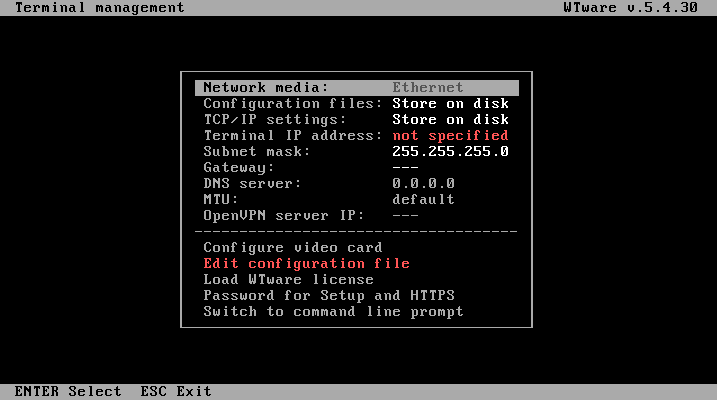

At first terminal start from local disk (from USB flash, SD card, hard disk) you'll see such screen:
You should tell terminal, where it's configuration file is stored. By default terminal is configured to store configuration file on local disk. It's convenient for first tests. Select menu item "Edit configuration file" and in editor write one line:
server=192.168.1.1
Instead of 192.168.1.1 specify your terminal server IP-address. Save configuration file, specify terminal IP-address, Exit menu by Esc and, if you're lucky, terminal will connect to terminal server. If not and there isn't image on the screen, read video configuration manual.
To enter this menu again, restart and press Del at the beginning.

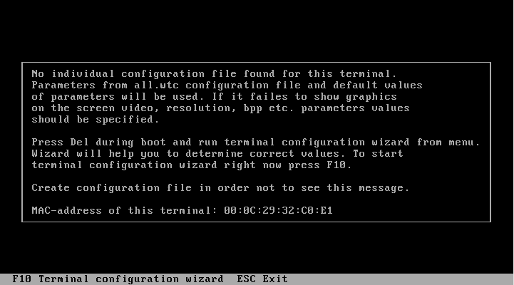

At first start terminal, configured to receive configuration by network, shows such screen:

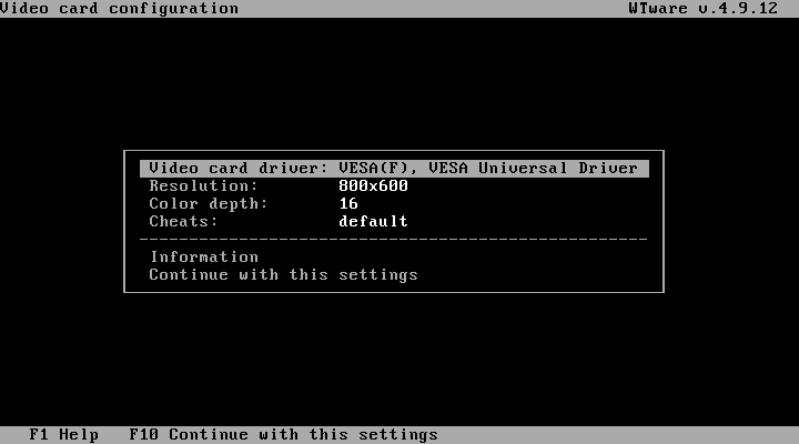

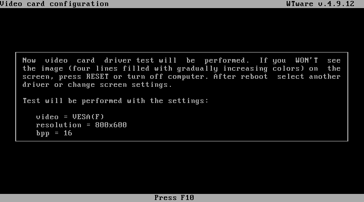

Select terminal video settings and press "Continue with these settings". Appears screen:
WTwizard, main screen

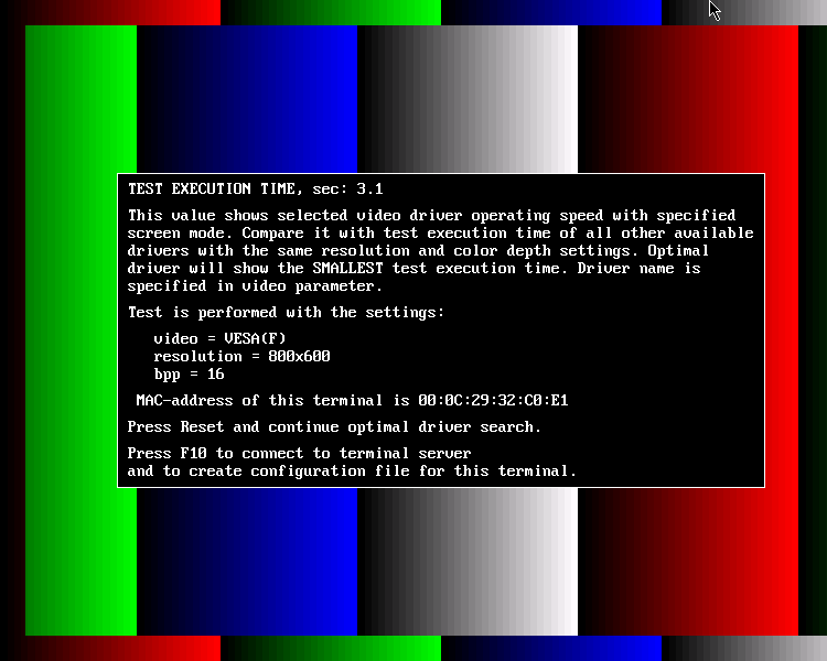

Press F10. Terminal video test starts. Successfull test looks so:
The smaller time - the faster terminal works in this mode with this driver.

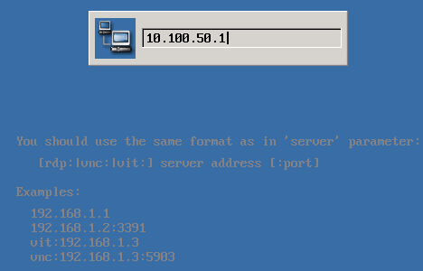

When you determined optimal video parameters for your terminal press F10 and connect to terminal server. Then you'll be able to save settings in terminal configuration file. And WTware will help you. Screen to specify terminal server address:

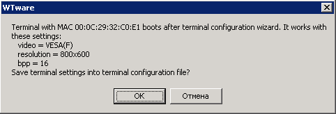

Also if you use configurator to edit terminal configurations run it after terminal boots on terminal server. After terminal wizard work WTware configurator at start suggests to create terminal configuration file and save there selected settings:
