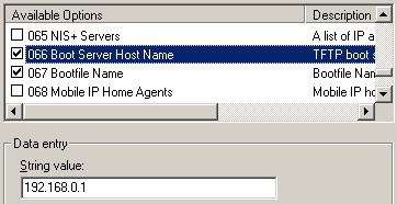

Network boot requires to set several DHCP parameters:
  1. 066, TFTP server address. specify address of the computer with WTware installed. In Microsoft DHCP set:
    In Unix DHCP set:
    next-server 192.168.0.1;
    Dual DHCP DNS Server:
    Next_Server=192.168.0.1

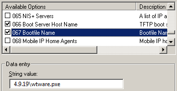

  2. 067, Boot file name. Specify full path from TFTP root to boot file including boot file. If you installed WTware using setup and use WTware TFTP then this path is: pro\4.1.32\ for WTware PRO version 4.1.32. After upgrade to the next WTware version you are to change this path manually. Boot file is pxelinux.0 when using PXE boot (i.e. BootROM is integrated into network card or motherboard by by manufacturer) or wtshell.nbi when using Etherboot loader (i.e. using BootROM emulator). In Microsoft DHCP set:
    In Unix DHCP set:
    filename "pro/4.1.32/pxelinux.0";

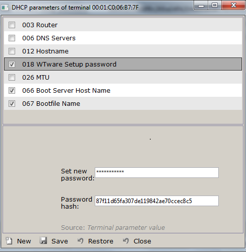

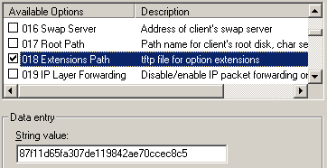

Using Setup menu you can install WTware on a hard disk (all disk data will be lost) or reconfigure terminal parmeters. If you want users to have no access to this menu set password. Unfortunately, this password can't be just set in configuration file, for during terminal load terminal haven't jet downloaded its configurtion file. This password should be specified in 018 DHCP (Extensions Path) parameter. We don't know any system/device/progam except WTware, tha uses this parameter value. You can easily specify this parameter: all other computers in the network will ignore it. This parameter value is distributed to all network computers, so password shouldn't be specified directly in dhcp parameter. Instead of password set parameter value to password hash-function, that is calculated by wtpassword.exe programm:
WTware password hash
For example if setup menu password is wtwaresetup specify hash in DHCP parameter. In Microsoft set:
In Unix DHCP set:
option extensions-path "87f11d65fa307de119842ae70ccec8c5";
Extension_Path=87f11d65fa307de119842ae70ccec8c5
